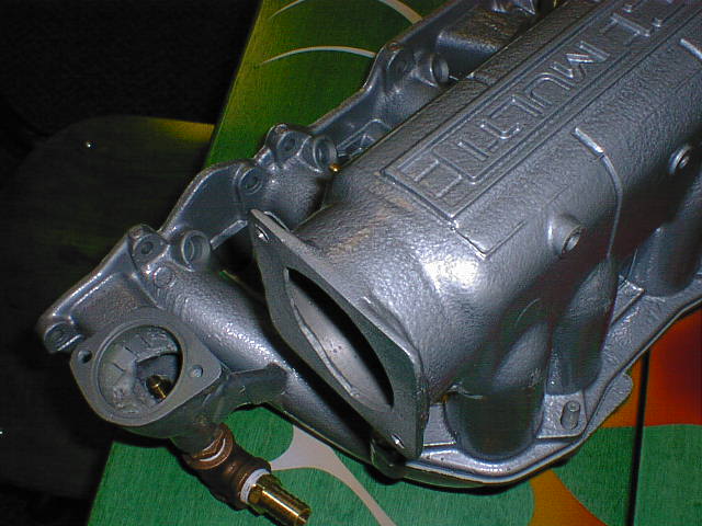

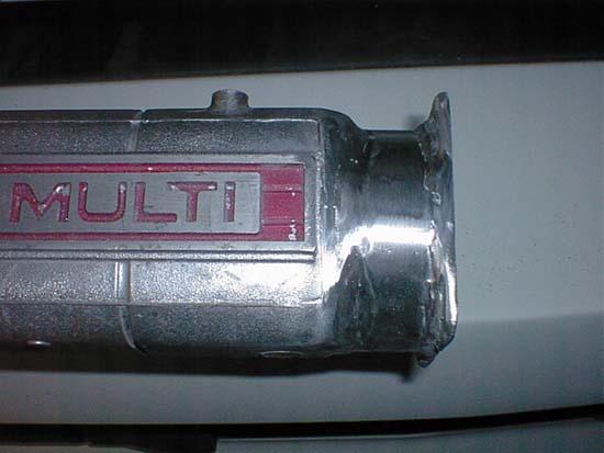

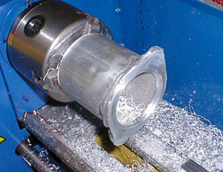

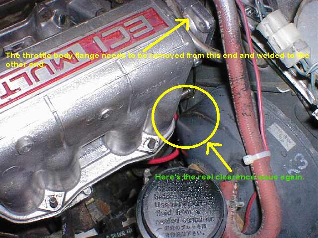

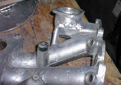

In September, I sold my business and actually made enough on the deal to have two nickels to rub together. I said screw it, shot the lock off my wallet and committed to swapping the TBI injection to MPI. This would involve getting rid of all the electronic stuff that was plaguing me so I kind of saw it as a guaranteed fix. The truck sat for a month or so, while I did my homework. MPI is expensive, no real way around it. There are lots of guys who do wacky stuff like drilling injector holes right on the stock manifold, and then gluing them in with JB WELD!!! But I wanted to do it right. I found a guy in a wrecking yard in Perth, Au. who sold me a manifold off of a Mitsu Magna. It is a naturally aspirated, front wheel drive sedan that was only delivered to Oz. The manifold is a direct bolt on, but requires extensive modifications to switch from the front drive application to our trucks. I could have bought one through the starquest guys, that was already modified, but Im glad I didnt. There is a lot more room in the bay of a starquest, and it would not have fit. I wound up buying a spoolgun for my mig welder, and learned to weld aluminum. It was a very tedious process, but it came out quite nice.
Upon Reflection...

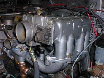

Would I do it again? NO WAY. For what the Magna costs, and still has to be modified, I would build my own intake in a second before doing that again. I would probably do all the design and cutting/bending work, and then have a pro tig weld it. Anyhow, I painted my manifold with a hammertone paint to hide all my non-pro work and it came out looking great. In fact, it is far and away the best looking part of my engine bay.

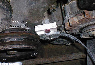

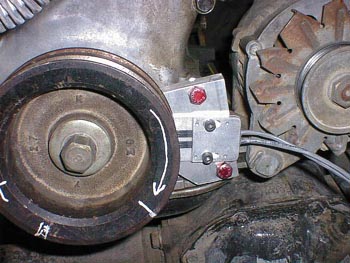

Upon FastEddys suggestion, I opted to go with a computer system from Simple Digital Systems, in Calgary. They were fantastic to work with and provided me with all I needed. I decided that since I was taking this big of a step anyway, I took their option of a direct fire spark control system, integrated with the fuel system. This eliminated the rest of the nearly twenty year old stuff from the original mitsu setup. I have no coil or distributor now, just coil packs from SDS that fire the spark plugs. Their system even came with a fuel pump relay for that crash safety thing. It installed without a hitch and fired up with minimal persuasion.

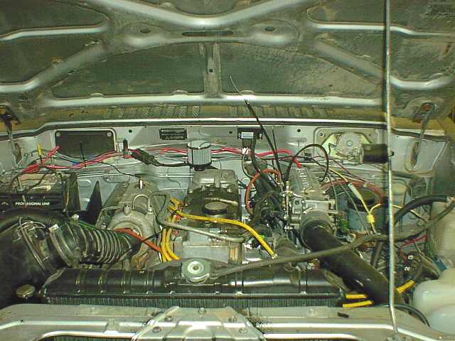

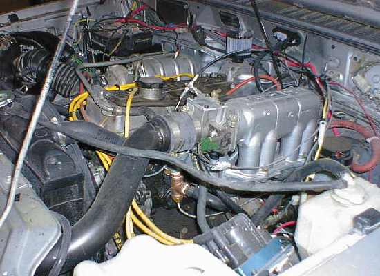

The Engine Bay
Dave D

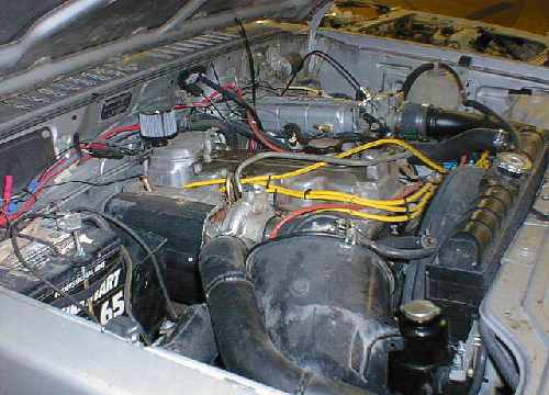

It looks OE
Dave D

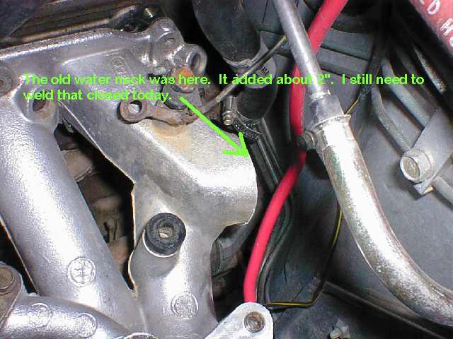

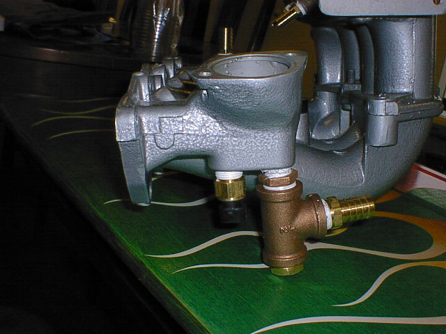

Water neck mod
Dave D
The Magna Intake
Dave D

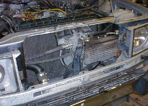

Oil cooler
Dave D

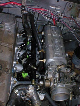

Intake plumbing
Dave D

The Magna intake is pretty
Dave D

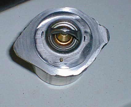

Need a thermo - STAT!
Dave D

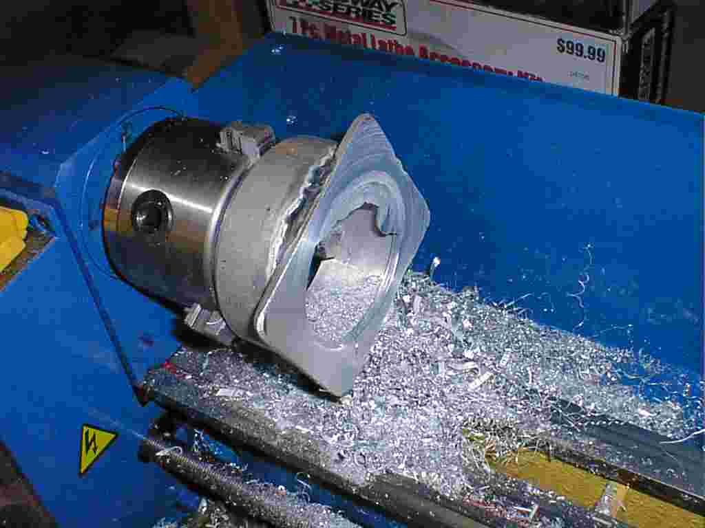

"Some" mods are necessary...
Dave D

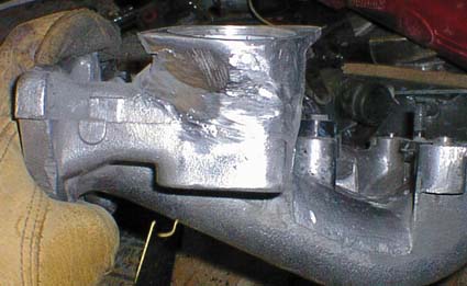

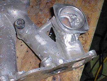

Did I mention I did some welding?
Dave D
The parts look like new again
Dave D
